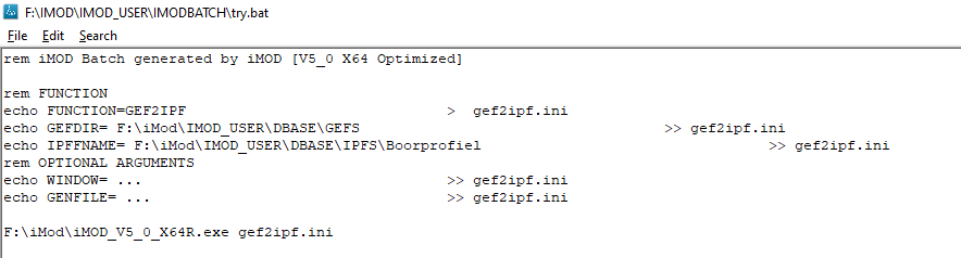

In my second try I used the iMod GUI to create the .BAT file (edit -> iModbatch) and fill in all the paths required for the GEF2IPF. I added a screenshot for this. Executing this .BAT through iMod, it will give the message "IMOD DID NOT find keyword: [IPFFILE] within settings File:{ini location}". This is probably caused by the fact that the .BAT file uses the word "IPFFname" and iMod is looking for "IPFFILE"? I changed both the names in the .INI and .BAT to IPFNAME and IPFFile, both didn't work. Changing to FILE would lead to a shutdown of iMod.

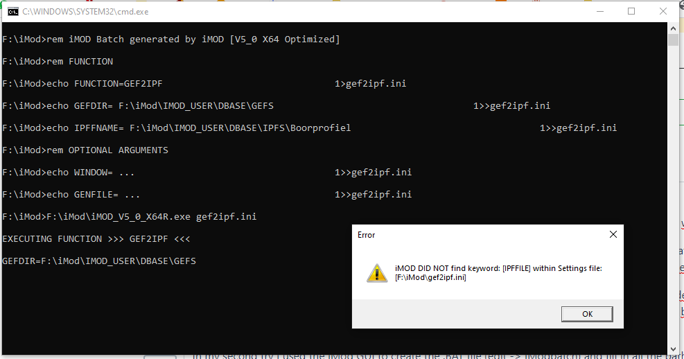

Edit: I tried running the GEF2IPF today and somehow I managed to run the script for a blink of an eye before closing down. I managed to get a screen shot of the error in the cmd prompt. It gives a syntax error and a problem with my list, so I suppose my GEFs arent compatible with iMod? Added another screenshot of the prompt.

Hi Noud, Your GEF files are OK. I found out that iMOD also needs to know what type of GEF file is given. Therefor the keyword GEFTYPE is given. Your GEF files are borelogs so choose GEFTYPE= 2.See also the documentation of this function in the manual chapter 8.7.4 GEF2IPF-Function. The keyword WINDOW and GENFILE are optional. I fixed the code on this.
So for now, please rewrite your *.BAT script file as below:
Kind regards, Frans
1 | rem FUNCTION |
2 | echo FUNCTION=GEF2IPF > gef2ipf.ini |
3 | echo GEFDIR= N:\Teams\Helpdesk-iMOD\imod\PR\forum\posts\2913627\gef >> gef2ipf.ini |
4 | echo IPFFile= N:\Teams\Helpdesk-iMOD\imod\PR\forum\posts\2913627\borelogs.ipf >> gef2ipf.ini |
5 | echo GEFTYPE= 2 >> gef2ipf.ini |
6 | "C:\imod\imod50\iMOD_x64_d.exe" gef2ipf.ini |
Kind regards, Frans
