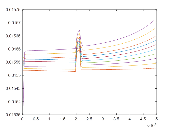

In the figure you sent:
The upstream load seems to be lower than equilibrium, indeed. Be aware that the number in the log file is `qbk` which is sediment transport per size fraction and unit width (i.e., m^2/s). I think the unit should appear in the log file. On the contrary, the input parameter in the morphodynamic boundary condition is `Qbk`, which is the total value per size fraction (i.e., m^3/s).
Could this be your problem?
