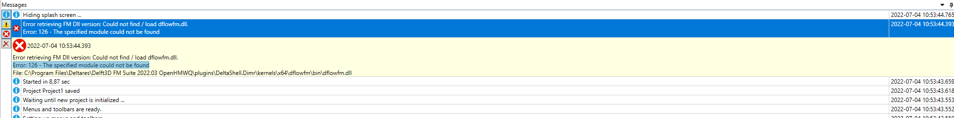

I've compiled the source code as written in the get started page for FM, without errors and successfully run the example files.
The "build_all" folder with the x64 subdirectory (am using windows 10 enterprise, intel procc.) is created as it should with all the kernel libraries compiled.
I´ve then copied all the compiled kernels from C:\delft3dfm_rep\build_all\x64\Release into the GUI folder: C:\Program Files\Deltares\Delft3D FM Suite 2022.03 OpenHMWQ\plugins\DeltaShell.Dimr\kernels\x64.
Still, I am getting the following error when running the FM Suite OpenHMWQ(2022.03) version:
Does anyone have an idea what the problem could be?

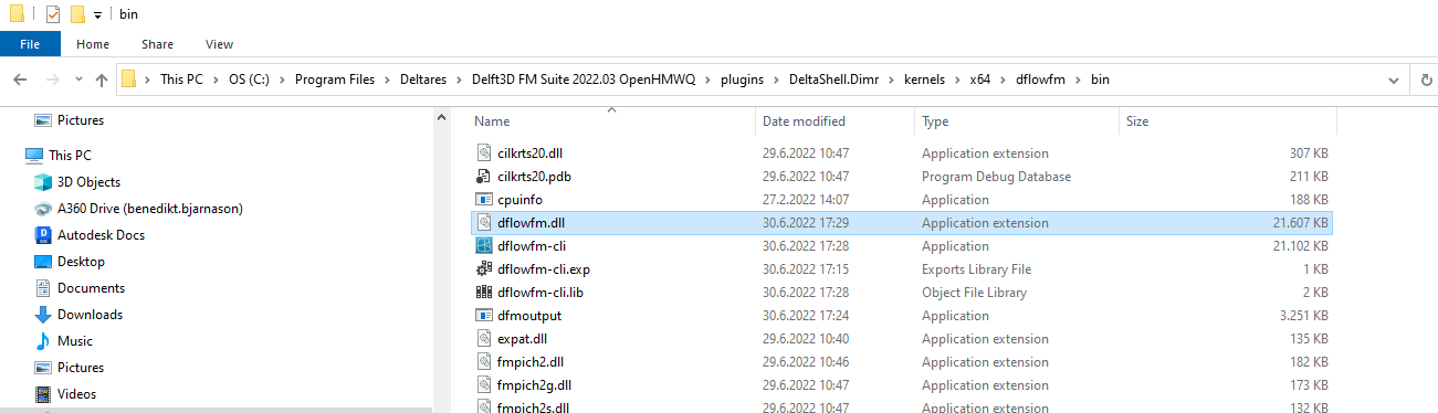

I´ve made sure the dflowfm.dll module is in fact in the directory the error is referring to:
Still I am getting the error when running FM Suite and cannot run a model. Everything else seems to be working fine.

The problem is solved. The current build.bat script only has the build settings for Intel oneAPI 2021. However, Intel has updated the complete oneAPI to a 2022.1 version. Setting the prepare.py as described here solved the problem: Compiling Delft3D FM with Visual Studio 2019 and Intel oneAPI (2021) - YouTube.
