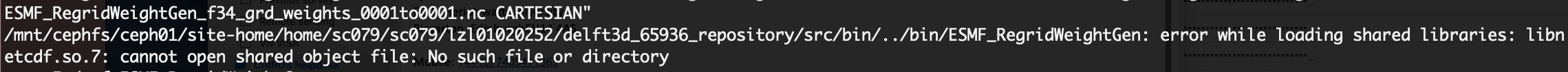

hi,
I am using the 65936 version and all examples run normally except the one in dflowfm/e100..._FM_WAVE/, below is the error message. looks like this library is not available in the netcdf-c-4.6.1 I installed, which version of netcdf I should use?

I sorted it out myself, just install the netcdf-c-4.3.3 version and add the lib into LD_LIBRARY_PATH environment.
