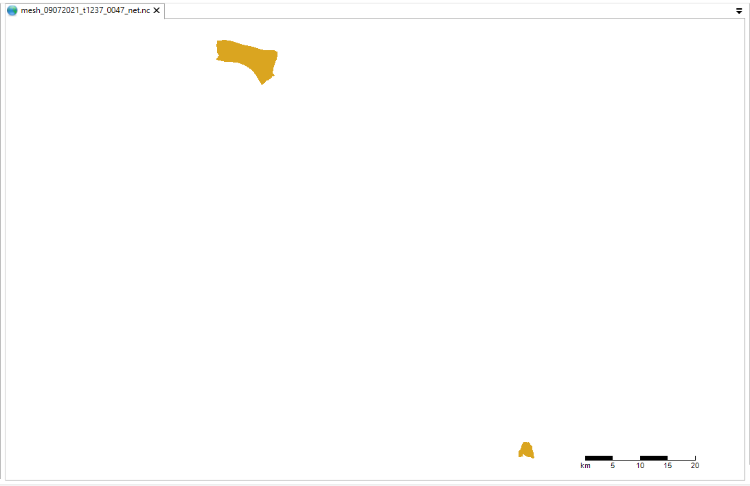

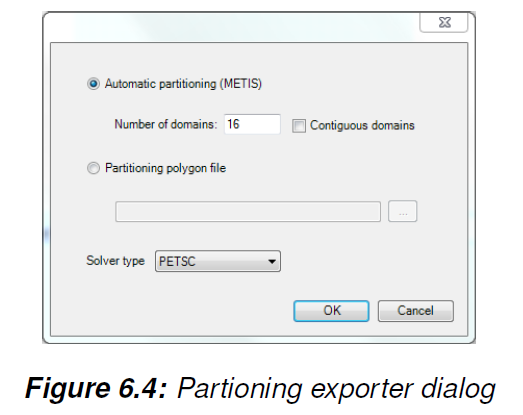

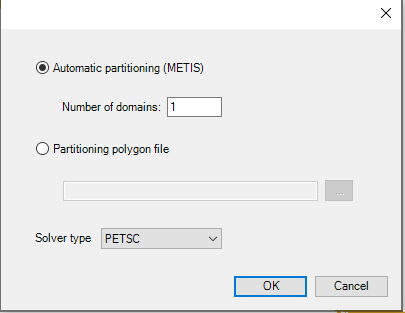

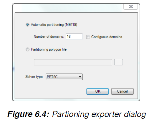

One thing I noticed is that my GUI does not contain the "contiguous domains" option which is present in the manual (see images below). Indeed, when I check my partition I see that there are some portions of the model which are discontinuous - is that what could be causing the issue?
My Delft3D-FM Partition Exporter Options:
Manual Delft3D-FM Partition Exporter Options:
Example of my discontinuous mesh:

I wanted to provide a brief update based on my recent testing. I was able to partition the model into a contiguous domain using a smaller number of partitions (n=2), but unfortunately that did not solve the problem either. So, the hypothesis I brought forward on the previous post is incorrect and I have no further explanations for why the model will not work now.
