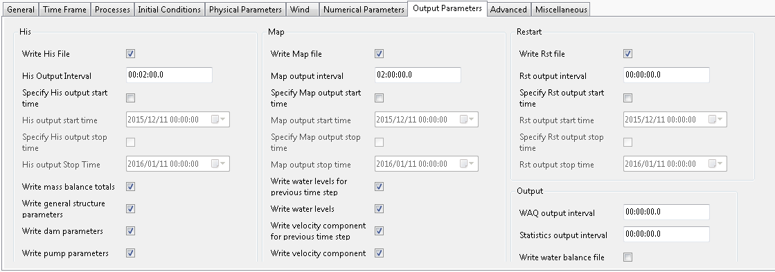

I had my user time step in the model set to 5min and my restart interval set to 24hrs(1140min) and I am hoping this would not cause any issues in writing the restart file as 1140 is a multiple of 5.
Attached figure shows the delta shell screen shot for this(RestarttimePNG).
