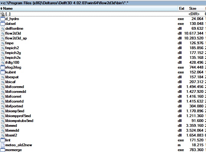

Which files are in your C:/Program Files/Deltares/Delft3D 4.02.02/win64/flow2d3d/bin directory? It should look like in the attachment. If the d_hydro.exe is not in this directory, your installation has been unsuccessful. Without more detailed information, we cannot advice you how to improve this.
