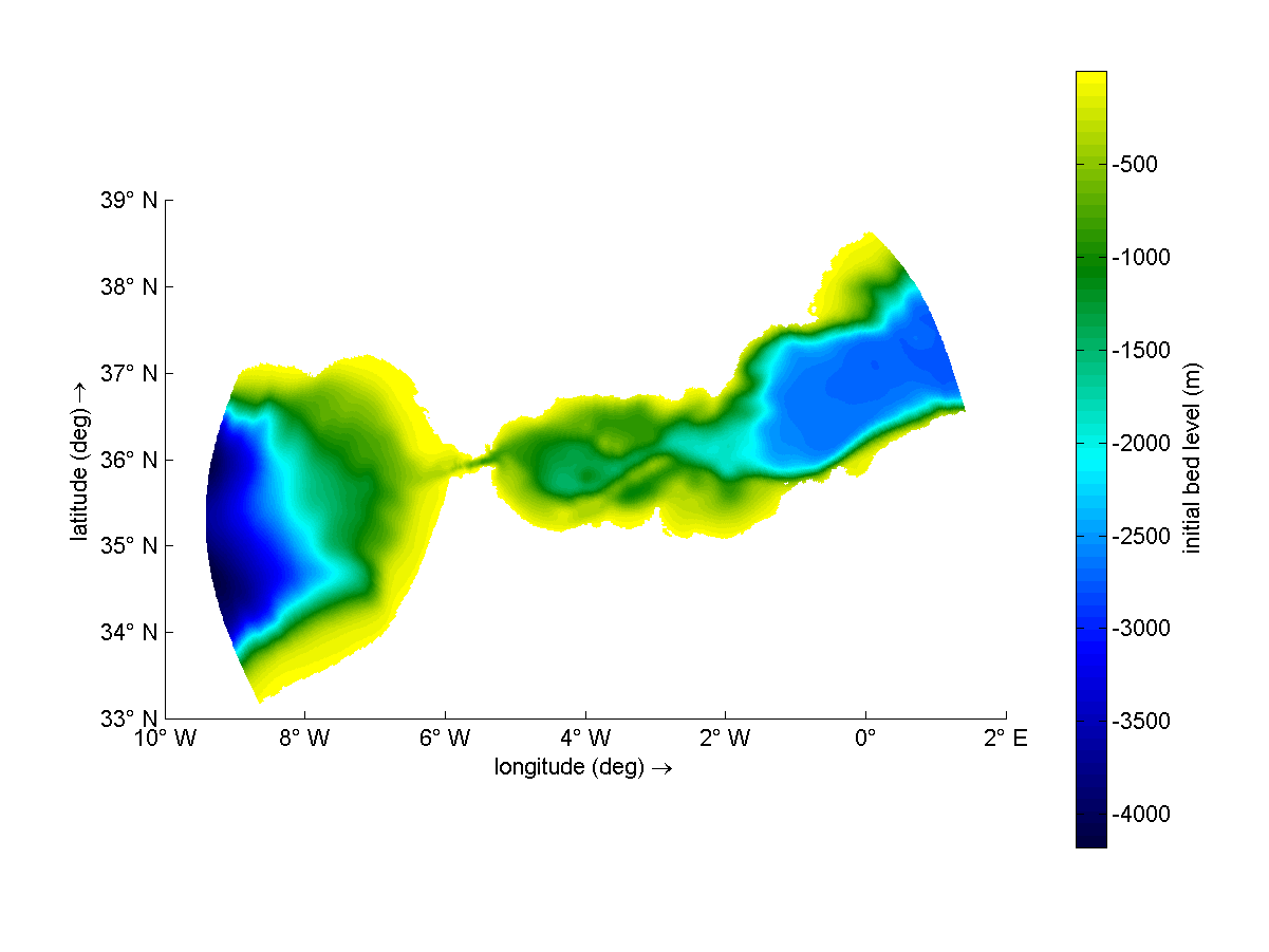

I'm trying to implement a simulation of the Strait of Gibraltar (South of Spain), with a domain spanning from the westernmost limit of the Iberian peninsula (San Vicente Cape) to approximately half of theĀ southern Spain Coast length (Cartagena). It is few hundreds of km, hence a quite big domain.
The grid is curvilinear, with spherical coordinates, and resolution is of order of 1-2 km in the large areas and few hundreds of meters in the very Strait.
I interpolated bathymetry from a variety of sources and then I smoothed it by iteratively computing the slope factor, so to guarantee it is never higher than abs(0.2).

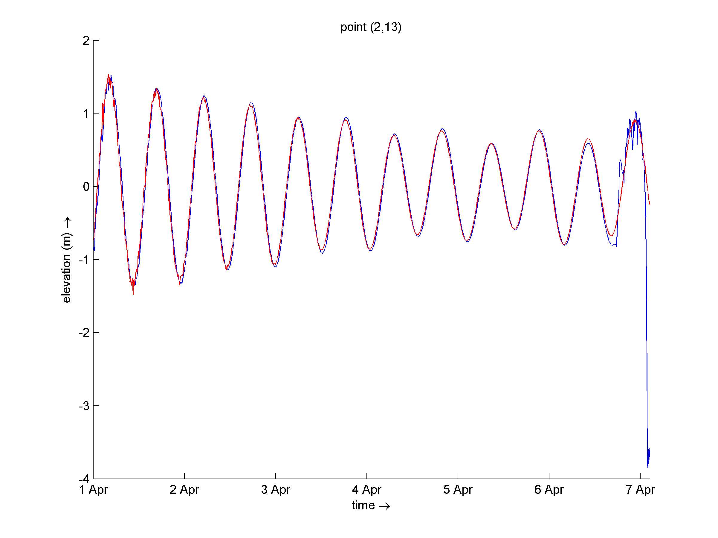

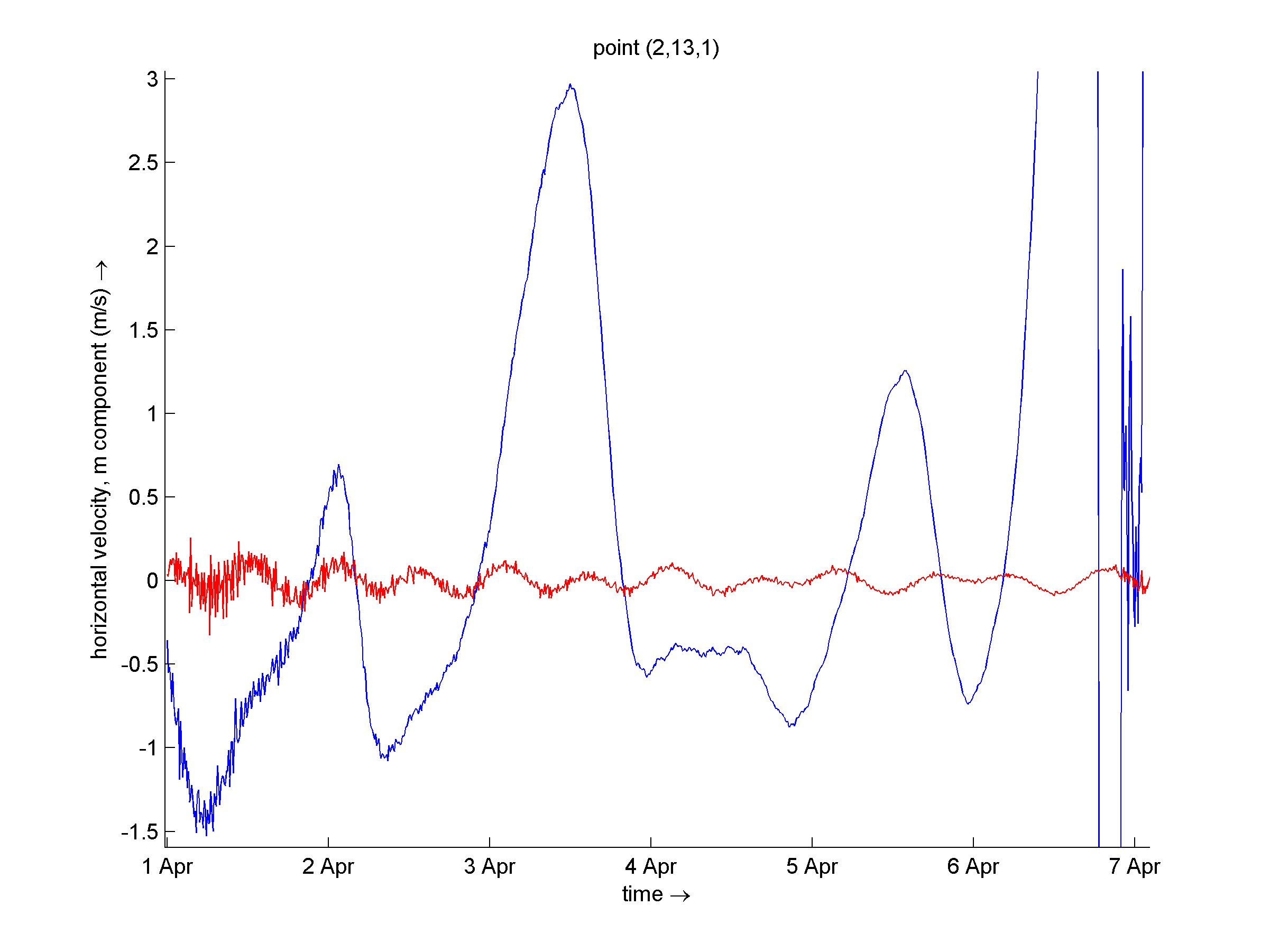

The run goes very well during the first 6 days, and then suddenly crashes. The more struggling fact is that the problem originates only at the northernmost cell of the western boundary and after 6 days of smooth and expected behavior. At that cell, despite the water level matches very well with the one imposed by the astronomic forcing, the current velocity behaves quite weird. It is not harmonic and, after 6 days it suddenly (with no previous changes of the sea level) starts increasing up to completely unreal values (of order of tens of m/s). Obviously, after few iteration, the CFL condition starts failing, and the model ends crashing.

I attach the .bca, and .mdf files and few screenshots of sea level and current of the western boundary. The blue line is the northern cell and the red one is the southern one.
