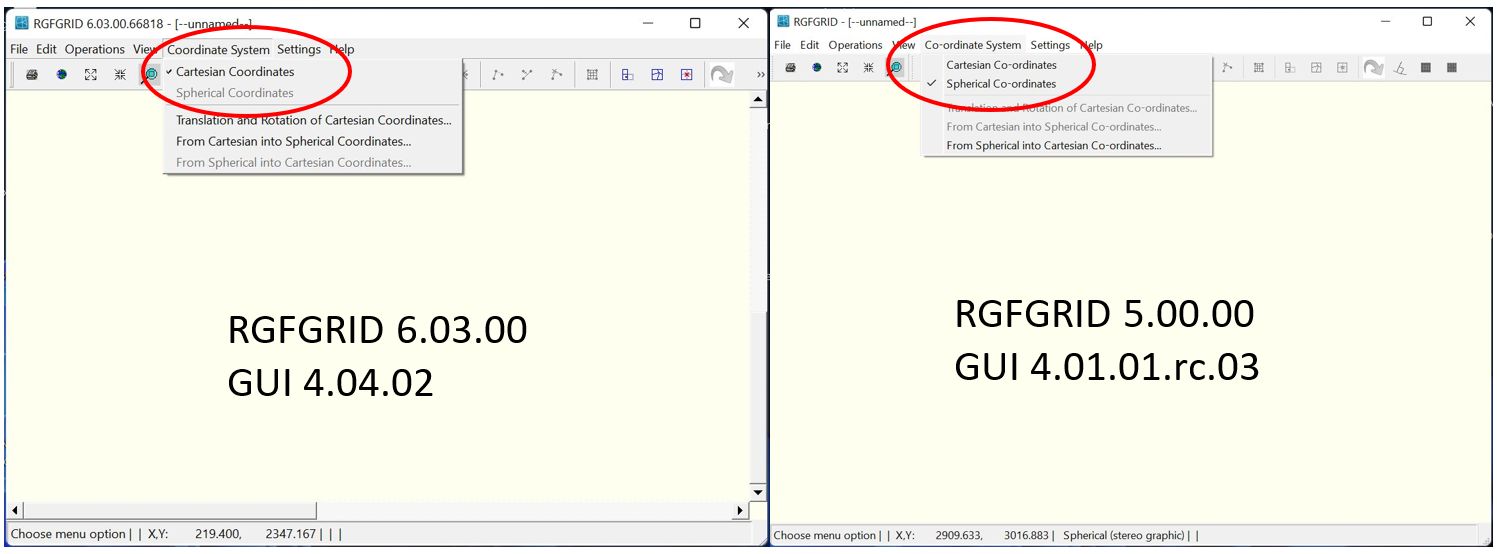

I found an error when open RGFGRID version 6.03.00.66818 from latest GUI 4.04.02, that is when I opened "Co-ordinate System > Spherical Co-ordinates". "Spherical Co-ordinate" submenu is dim, so I can't select it in advance. This problem was not found in previous RGFGRID version 5.00.00 of GUI 4.01.01.rc.03. Anybody has the some problem and what is the solution? Here I attached the screenshot for both RGFGRID versions. Thanks

I share a little video showing you how I change the coordinate system in RGFGRID (ver. 6.03.00.6681 Win 64). I hope this video can help you.
