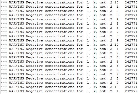

First, my model represents an estuary, under temperature and salinity processes and which is forced with astronomical tide at sea and with freshwater discharges in several upstream areas. The heat flux models used are absolute flux, net solar radiation and absolute flux, total solar radiation. The model is divided into 12 domains and is executed using DomainDecomposition. Warning messages appear when turning on the heat flux models and appear both when launching the complete simulation and when launching individual domains.
The Warnings are as shown in the attached image. In them we have a position, l, which does not refer to the mesh location, and a position, k, which refers to the layer. Sometimes they appear only in the first layers (k=1,2); however, it is common for them to appear in all of the layers and to appear duplicated, as shown in the attached image. I have not found any pattern associated with sea level change.
