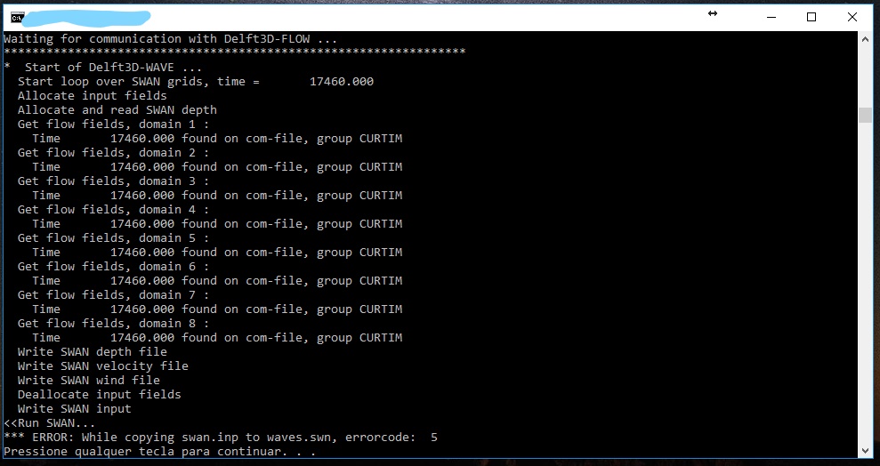

I am founding an error performing SWAN simulations and I was not able to solve it.
I have already created new versions of input files, changed folders, changed delft version for an older one that I have here and nothing worked.
The image attached shows more details of the error.
Has anyone seen something like that? Or knows what else it could be?
Thank you very much!

Hi Lucas,
Looking in the source code: it goes wrong when trying to create file "<runid>.swn", were <runid> is the base name of your mdw-file (e.g. if your mdw-file is named "test.mdw", then <runid> is "test"). Can you try to remove that swn-file from the working directory manually? Alternatively: what happens when you start with an empty working directory and copy all the input files in there, excluding the swn-file?
