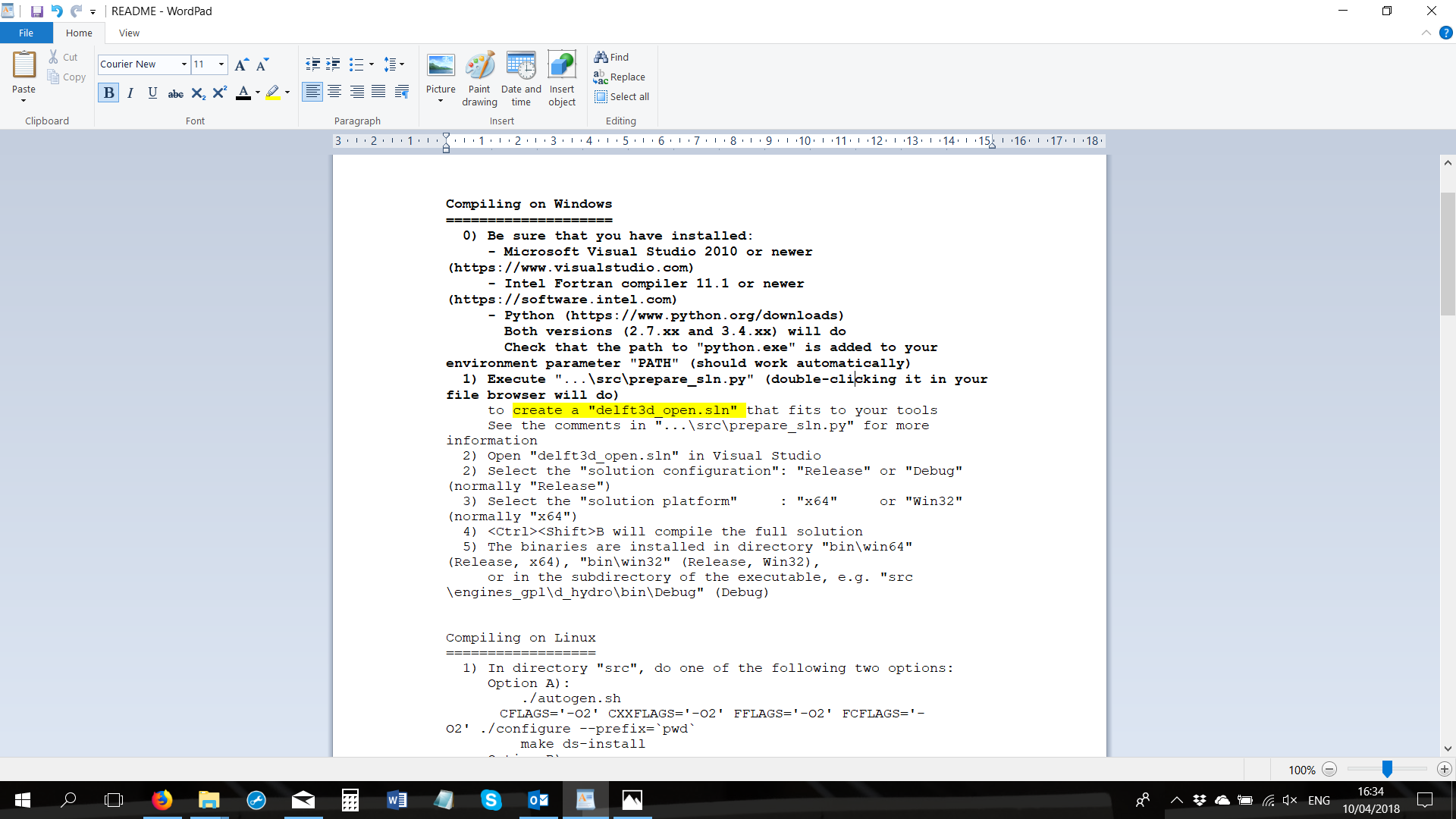

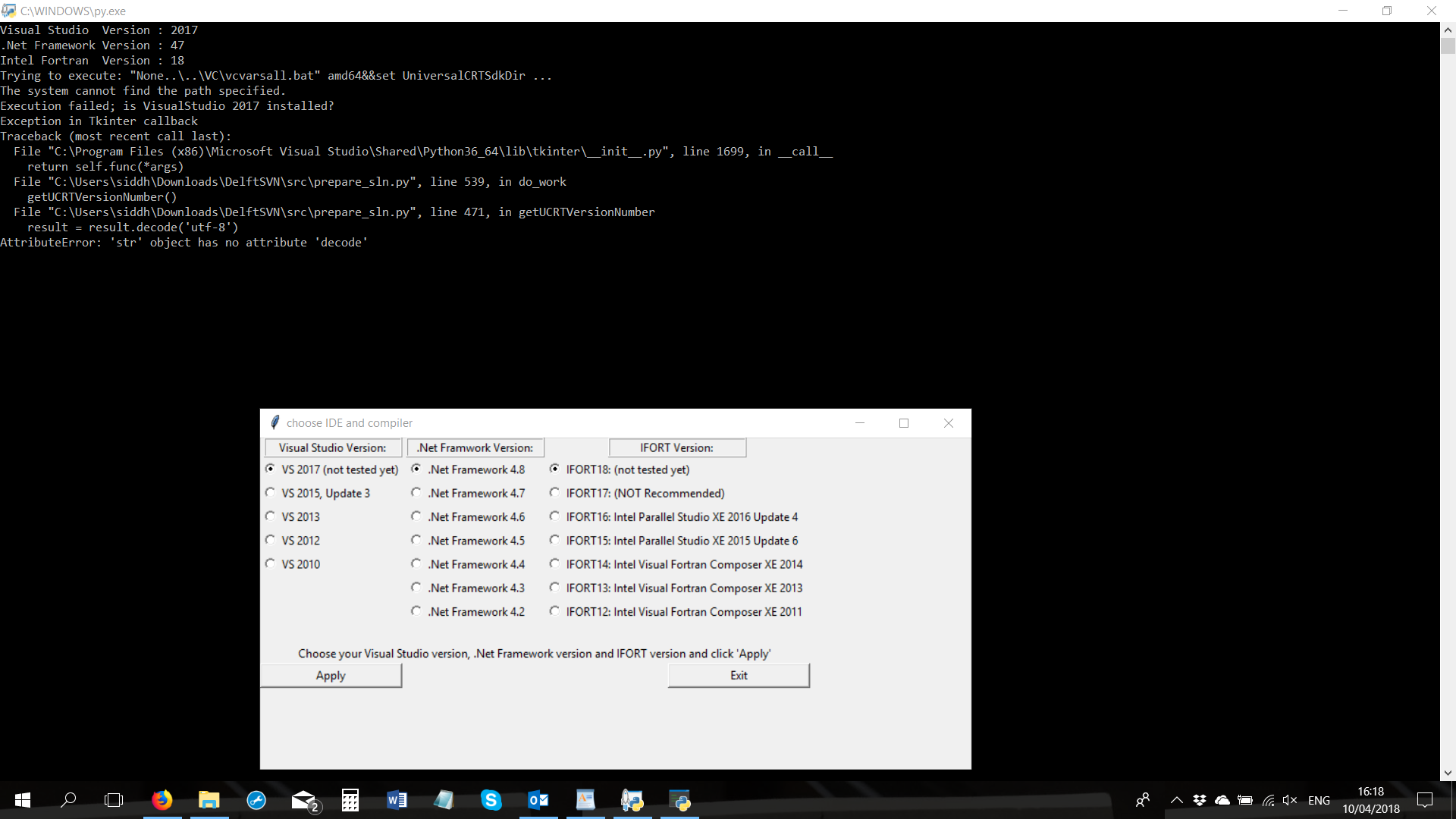

I am trying to compile the latest trunk version of Delft 3D on Windows 10 and have the following prerequisites installed. Unfortunately I am having trouble generating the python file after running prepare_sln python file (screen shot attached with Command line error). Hence I am unable to generate the python file delft3d_open.sln

I'm afraid you have to modify the script "prepare_sln.py" yourself to fit to your system. Line 186 is:
getucrtdir["2017"] = '"' + str(os.environ.get("VS140COMNTOOLS")) + "..\\..\\VC\\vcvarsall.bat" + '" amd64&&set UniversalCRTSdkDir'
It seems that environment parameter VS140COMNTOOLS does not exist on your system. Can you find out what the correct way is to reach the "vcvarsall.bat" script?

The string "getucrtdir" is executed in a separate process to detect the location/name of the ucrt directory, see line 467 in the prepare_sln.py script. It seems that the VisualStudio behaviour is changed in VS2017. I don't expect that the change in "working directory" causes the problem. But I'm not able to investigate this problem.
