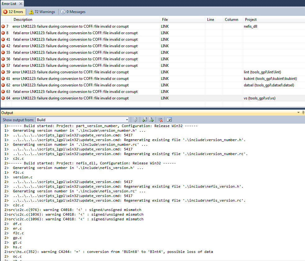

Hi All
I downloaded the version Tagged 5.01.00.2163 and compiled it using Vistual Studio 2010 and Intel Parallel Studio XE2011. I got many "error LNK1123: failure during conversion to COFF: file invalid or corrupt". After that, I tried the tagged version "https://svn.oss.deltares.nl/repos/delft3d/tags/5389/" as per Adri's suggestion, the solution file was generated successfully by the Python script, but I still got 12 pretty much same errors and 72 warning , please see the pasted below and attached screenshot:
Please give me any help?
Many many thanks,
haifeng
Error 7 error LNK1123: failure during conversion to COFF: file invalid or corrupt C:\delft3d5389\src\utils_lgpl\nefis\packages\nefis\LINK nefis_dll
Error 8 fatal error LNK1123: failure during conversion to COFF: file invalid or corrupt LINK
Error 41 fatal error LNK1123: failure during conversion to COFF: file invalid or corrupt LINK
Error 42 fatal error LNK1123: failure during conversion to COFF: file invalid or corrupt LINK
Error 55 fatal error LNK1123: failure during conversion to COFF: file invalid or corrupt LINK
Error 56 fatal error LNK1123: failure during conversion to COFF: file invalid or corrupt LINK
Error 57 fatal error LNK1123: failure during conversion to COFF: file invalid or corrupt LINK
Error 59 error LNK1123: failure during conversion to COFF: file invalid or corrupt C:\delft3d5389\src\tools_gpl\lint\packages\lint\LINK lint (tools_gpl\lint\lint)
Error 61 error LNK1123: failure during conversion to COFF: file invalid or corrupt C:\delft3d5389\src\tools_gpl\kubint\packages\kubint\LINK kubint (tools_gpl\kubint\kubint)
Error 62 error LNK1123: failure during conversion to COFF: file invalid or corrupt C:\delft3d5389\src\tools_gpl\datsel\packages\datsel\LINK datsel (tools_gpl\datsel\datsel)
Error 63 fatal error LNK1123: failure during conversion to COFF: file invalid or corrupt LINK
Error 64 error LNK1123: failure during conversion to COFF: file invalid or corrupt C:\delft3d5389\src\tools_gpl\vs\packages\vs\LINK vs (tools_gpl\vs\vs)

Uninstall .NET Framework 4.5 and install .NET Framework 4.0

Hi Dmitry?
Thanks so much. The version tagged 5389 was compiled successfully after using .NET Framework 4.0 with 0 error and 78 warnings, see below pasted. Do these warnings impact the model significantly or not? Are they matter?
Thanks again.
Haifeng

Hi Haifeng,
I don't expect that these warnings will be harmful. You probably will resolve a part of these warnings when starting a compilation in a clean, freshly checked out version.
In revision 5422 (currently only available in the trunk), I added the .Net Framework specification in the GUI of "prepare_sln.py". To make life easy for everybody, it would be nice to improve the "prepare_sln.py" script. I'll put that on our To Do list. Suggestion improvements are welcome.

Choosing .Net Framework version in "prepare_sln.py" is implemented in revision 8317.
