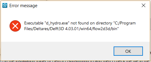

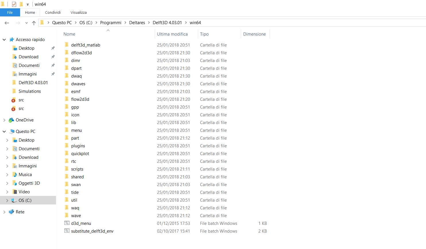

I have a problem in copying the compiled binaries in the Delf3D-GUI folder.
I followed the instructions in http://oss.deltares.nl/web/delft3d/source-code and I already checked in FAQ.
When I copy the folder win64 (from my compiled code folder) in the installation folder of Delft3D (substituting it) and then I check the file in the new win64 folder, I see that it didn't substitute some folders (such as flow2d3d, folders shown in picture_1), because they have different names (e.g. dflow2d3d and flow2d3d).
The problem is, when I try to run a simulation using the Delft3D-GUI, I get this message: (it is shown in picture_2, attached)
Obviously it searchs "d_hydro.exe" in "C:/ProgramFiles/Deltares/Delf3D 4.03.01/win64/flow2d3d/bin" and it doesn't find it since the compiled binaries are in folder "dflow2d3d" and not in folder "flow2d3d".
I tried to simply substitute the folder changing its name from "dflow2d3d" to "flow2d3d", but Delft3D didn't run and showed the window in picture_3 (attached).
Maybe it's a dumb thing, but following the instruction on the website I should just copy the folder "win64" and allow to substitute the file, but it doesn't work.
I tried to run also "substitute_delft3d_env.exe" but the command window opens and closes immediately.
May be this one the problem?
Does anyone have a solution for that?
Executable "d_hydro.exe" not found on directory"C:/ProgramFiles/Deltares/Delf3D 4.03.01/win64/flow2d3d/bin"
//update: I compiled this trunk version, because I can't compile the last tag version (7545).
Thanks everyone,
Pietro

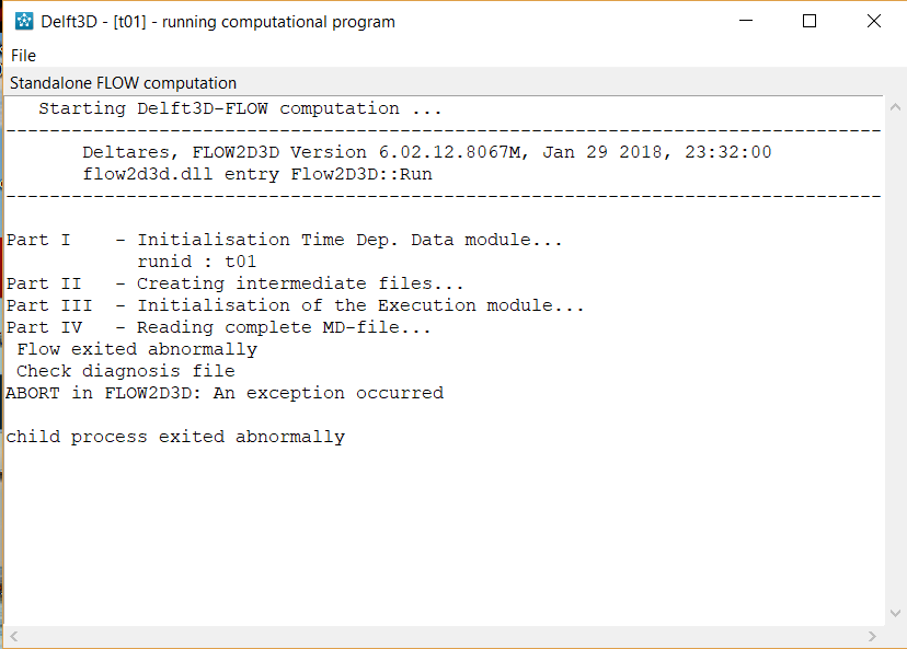

Pietro Mazzon, modified 8 Years ago.
RE: Problems in copying compiled binaries in Delt3D-GUI installation folder
Youngling Posts: 9 Join Date: 12/26/17 Recent Posts
Hi David!
Thanks again for the answer.
I'm using vs2015 and ifort16 (I tried with Vs 2017 and ifort18 but I couldn't compile).
I tried the two last tagged versions and with the last trunk version until now (in Vs I chose release, x64, as written in the instructions). But with all of them, the compilation stops when is has to compile the file flow2d3d_openda, saying that this package is not required to be installed in the x64 release. Then the compilation does not proceed and I have to shut down the system since it stops to work (I can't even run the task manager).
When I check in the folder both d_hydro.exe and flow2d3d are present, so I thought that it worked. But when I copy it in the GUI folder and I try to run it, it starts correctly but stops after a few seconds.
I don't really know why.
Do you have any suggestions?
And do you maybe know how to modify the batch_flow file created by delft dashboard in order to point to d_hydro.exe?
Maybe if I can run that bat file the program will work.
Thanks a lot!
Pietro

Hi Pietro,
If the compilation process is not correctly finished, I would not trust the results. As you mention, d_hydro.exe might run, but who knows if what is happening behind is fine. So I would not go further without the compilation being correct.
I find it a bit odd that you have to shut your system down because the compilation "freezes". I have never seen that with Visual Studio.
regarding the compilation, in order to be able to solve the "problem" when getting through flow2d3d_openda I would need a bit more detailed description:
- SVN Checkout of tag (number?)
- Did you use the python script to generate the solution?
- Output from that script.
- Which solution do you open?
- You use x64, but Debug or Release?
- How long have you waited until shutting the system down?

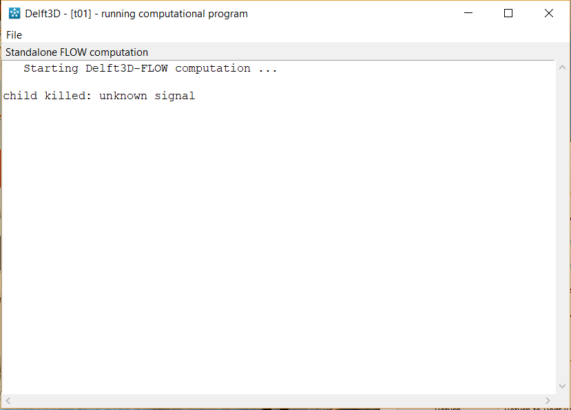

That said, if you want to verify your existing exes:
When you say that the program stops after a few seconds, what model are you using to test if it runs?
A common reason for that behavior is bad model input.
Are you testing the exe with a model prepared by yourself?
What is the output of your run diagnostic files?
Have you tried running from the GUI the examples that come with the src?
Best,
David
Best,
David
Hi David,
Here the info that you asked:
-I tried with versions tag 7545 and 7426 and with the trunk version 8067
-Yes, I used the python script (selecting VS2015 Update 3 with .NET Framework 4.6 and IFORT2016: Intel Parallel Studio XE 2016 Update 4) and everything worked fine
-Outputs from that script: It created the .sln file "delft3d_open", "nefis" and "io_netcdf" and it modified some folders adding some file to them (folders: Tools_gpl, Scripts_lgpl, logs, utils_lgpl, engines_gpl, utlis_gpl, plugins_lgpl, third_party_open, tools_lgpl, m4)
-I run "delft3d_open.sln"
-I use x64, Release
-I tried to wait 20 minutes and 2 hours, but nothing changed. VS sais "ready" and the building doesn't proceed after skipping the compilation of "flow2d3d_openda"
-The examples from the respository folder run, but I'm not completely sure that the outputs are correct since I don't know what they have to produce!
-Yes, I prepared the model in Delft Dashboard following the instructions in the webinar about Delft Dashboard.
You were right! I tried to run the example standard_01 from Delft3D GUI (I ran FLOW and I selected the mdf file "f34.mdf") and the program worked!
I also tried to redo the file preparation using Dashboard and following the step-to-step instructions of the seminar, but I got the same error of the other time, attached at the post.
Let me know if you need more info.
Thanks!
Pietro
-I use x64, Release
Thanks!
Pietro
David Gutiérrez, modified 8 Years ago.
Youngling Posts: 5 Join Date: 1/6/12 Recent Posts
Hi Pietro,
If f34 runs, now it's a matter of the model prepared with the dashboard.
As the error states, now it's time to check the diagnosis file. In the directory where your mdf file is, there should be some diagnostic files (they have "dia" in their names").
What are the contents of those files?
Best,
David
Best,
David
Hi David!
Don't know why, but after a few tests (just changing the boundary conditions in Delft Dashboard) my model ran.
Probably the source code compilation was complete, just VS freezed when it skipped the installation of "flow2d3d_openda", since everything is working (at least regarding what I'm using).
I really thank you for your help! I really appreciate it!
Just a feedback on the source code compilation to the developers: apparently my compilation freezed when it skipped the installation of "flow2d3dopenda", saying that for release x64, that installation was not needed. Then the system crushed.
So maybe you can try to fix this issue!
Thanks,
Pietro
Thanks,
Pietro
RE: Problems in copying compiled binaries in Delt3D-GUI installation folder (Answer)
Hi Pietro,
I am glad to hear that your simulation is running now.
To me, boundary conditions are normally the reason of the model complaining so it is not a surprise ;-)
Since your "Building software" combination is not the most recent and the chance of replicating the problem can be quite low, I don't know if someone will try to fix it...
Anyway, any further question, don't hesitate asking.
Best,
David
Best,
David
