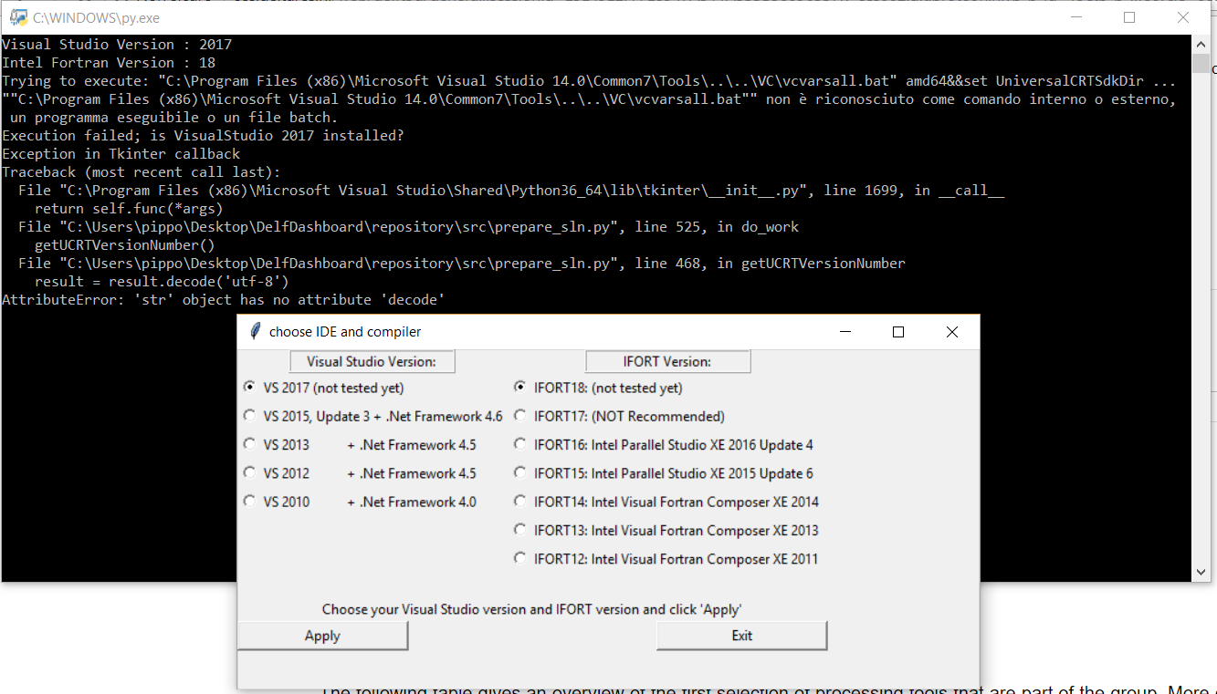

Hi everyone,
I'm trying to compile the lastest version of the Delft3D source code (7545), but when I run the "prepare_sln" file form "src" folder and the window to choose the versions of Visual Studio and Intel Fortran shows, I get a problem.
I choose the versions VS 2017 (professional) and IFORT18 (I checked that they are correctly installed and IFORT component is correctly added to Visual Studio) but when I click apply in the command window error showed in the attached file occurs.
I'm using Python 3.6.4 (lastest available), on a Win10 PC.
(I'm sorry for the part in italian: ""C:\Program Files (x86)\Microsoft Visual Studio 14.0\Common7\Tools\..\..\VC\vcvarsall.bat"" non è riconosciuto come comando interno o esterno, un programma eseguibile o un file batch.
It sais that the file "vcvarsall.bat" is not recognized as an internal or external command, an executable program or a batch file)
I saw in another thread that even if these two versions of VS and IFORT are not tested yet, can be succesfully used to compile the source code.
Does someone has a solution to this poblem?
I would really appreciate your help, I'm being mad with that!!
Thanks to everyone,
Pietro

Adri Mourits, modified 8 Years ago.
RE: Error compiling Delft3D source code VS 2017 and IFORT18
Padawan Posts: 97 Join Date: 1/3/11 Recent Posts
Hi Jorge and Pietro,
I'm sorry, I didn't test yet with VisualStudio 2017+Ifort18 yet. What happens if you remove/disable line 525 in prepare_sln.py: getUCRTVersionNumber()
I'm surprised you are able to compile the key parts of Delft3D (flow2d3d and wave, unfortunately not waq), given that prepare_sln.py crashed.
After running example 07, you should be able to open both the NetCDF and the Nefis wavm_obw output files in QuickPlot and inspect computed results. May be the QuickPlot "open file"-dialogue window is filtering these files out.
Forget about nefis.sln and io_netcdf.sln. You probably don't need them.

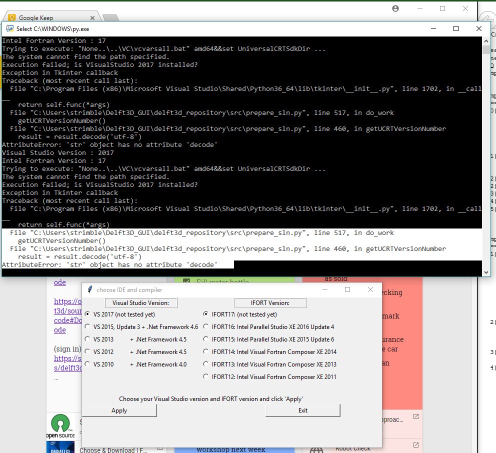

Sarah Margaret Trimble, modified 8 Years ago.
Youngling Post: 1 Join Date: 5/24/18 Recent Posts
Hi all,
I see that the last update to this thread was > 3 months ago; however I have just had the same initial error (string has no attribute "decode" -- see attachment). The winding thread of solutions here is hard to follow. Is it still recommended that I first try removing (commenting out) line 524 using visual studio?
Thanks for your help --
Sarah
Seb Pitman, modified 8 Years ago.
Youngling Posts: 2 Join Date: 5/23/18 Recent Posts
Hi Sarah,
I've come up against the same problem today (VS 2017 enterprise and Ifort 18).
I took a look in the Programme Files and found the vcvarsall batch file that was being called, and then simply substituted its path into the prepare_sln file on Line 186, as follows:
