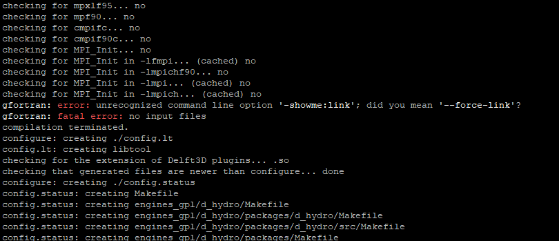

Hi, I am trying to compile delft3d in fedora-25 by following the steps of ubuntu installaions.
I ran $ ./autogen.sh
./Configure
checking for MPI_Init in -lmpichf90... no
checking for MPI_Init in -lmpi... (cached) no
checking for MPI_Init in -lmpich... (cached) no
gfortran: error: unrecognized command line option '-showme:link'; did you mean '--force-link'?
gfortran: fatal error: no input files
compilation terminated.
configure: creating ./config.lt
config.lt: creating libtool
checking for the extension of Delft3D plugins... .so
checking that generated files are newer than configure... done
configure: creating ./config.status
config.status: creating Makefile
config.status: creating engines_gpl/d_hydro/Makefile
config.status: creating engines_gpl/d_hydro/packages/d_hydro/Makefile
config.status: creating utils_lgpl/ods/Makefile
config.status: creating utils_lgpl/ods/packages/Makefile
config.status: creating utils_lgpl/ods/packages/ods/Makefile
config.status: creating utils_lgpl/ods/packages/ods/srcf/Makefile
config.status: creating utils_lgpl/ods/packages/ods/src/Makefile
config.status: creating config.h
config.status: config.h is unchanged
config.status: executing depfiles commands
config.status: executing libtool commands
<<<end of configure>>>

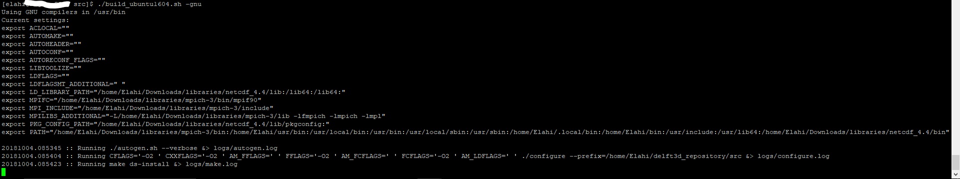

After following all the steps of "build_ubuntu.16.04LT.readme", above errors are solved. However, now I am getting new errors related to uuid library. uuid package is already installed, but don't know why make cannot find -luuid. Errors are given below:
../../../../../engines_gpl/part/packages/utils_f/src/.libs/libutils_f.a ../../../../../engines_gpl/part/packages/kernel_f/src/.libs/libkernel_f.a ../../../../../engines_gpl/part/packages/io_f/src/.libs/libio_f.a ../../../../../engines_gpl/part/packages/data_f/src/.libs/libdata_f.a -lpthread -luuid -ldl -lrt -lexpat -lstdc++ -pthread -fopenmp -Wl,-rpath -Wl,/home/Elahi/delft3d_repository/src/lib -Wl,-rpath -Wl,/home/Elahi/Downloads/libraries/netcdf_4.4/lib -Wl,-rpath -Wl,/home/Elahi/Downloads/libraries/hdf5-1.8.13/lib
/usr/bin/ld: cannot find -luuid                  (* but uuid package is there in same directory)
collect2: error: ld returned 1 exit status
Makefile:631: recipe for target 'delwaq1' failed
make[6]: *** [delwaq1] Error 1
make[6]: Leaving directory '/home/Elahi/delft3d_repository/src/engines_gpl/waq/packages/delwaq1/src'
Makefile:755: recipe for target 'install' failed
make[5]: *** [install] Error 2
make[5]: Leaving directory '/home/Elahi/delft3d_repository/src/engines_gpl/waq/packages/delwaq1/src'
Makefile:488: recipe for target 'install-recursive' failed
make[4]: *** [install-recursive] Error 1
make[4]: Leaving directory '/home/Elahi/delft3d_repository/src/engines_gpl/waq/packages/delwaq1'
Makefile:496: recipe for target 'install-recursive' failed
make[3]: *** [install-recursive] Error 1
make[3]: Leaving directory '/home/Elahi/delft3d_repository/src/engines_gpl/waq/packages'
make[2]: *** [install-recursive] Error 1
make[2]: Leaving directory '/home/Elahi/delft3d_repository/src/engines_gpl/waq'
Makefile:493: recipe for target 'install-recursive' failed
make[1]: *** [install-recursive] Error 1
make[1]: Leaving directory '/home/Elahi/delft3d_repository/src/engines_gpl'
Makefile:548: recipe for target 'install-recursive' failed
make: *** [install-recursive] Error 1
<<<end>>>>
I have attached the log files. I have been trying to compile for a long time. Now I am getting frustrated and losing hope. Any kind of help or suggestion will be highly appreciated.

In cofigure.log i found an error line as given below:
checking for MPI_Init... yes
checking for mpi.h... yes
checking for openmpif77... no
checking for mpif77... mpif77
checking for mpif.h... yes
checking for openmpif90... /home/Elahi/Downloads/libraries/mpich-3/bin/mpif90
gfortran: error: unrecognized command line option '-showme:link'; did you mean '--force-link'?   (any suggestion regarding this please?)
.............. (lots of line without any error)
<<<end of configure.log>>>
