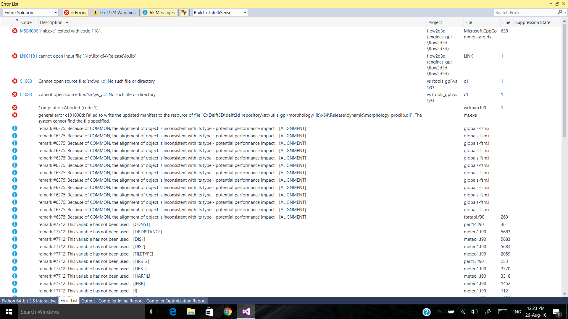

Hello everyone!
It`s my first time using Visual Studio and I had a lot of problems, most of which I could solve with other answers in thw forum. I'm still running into the problems in the attached image(errp) during compilation. Also during compilation the program couldn't execute this files: flex.exe and byacc.exe

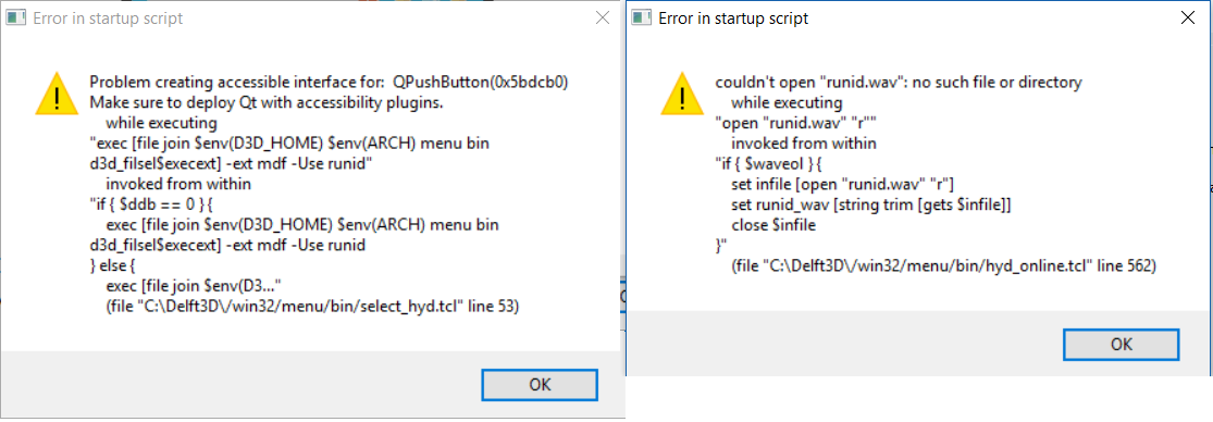

I tried to use the files generated despite the compilation problems but my flow mode gives the errors in the attached images(error)
Any help will be much appreciated!

Youngling Post: 1 Join Date: 3/26/18 Recent PostsHi ! i'm using the lastest version of Delft3D . and i do had the same problem ...but it shows up this message when i try to run a computation
"couldn't open "runid.wav" ".
please any help

About your compilation problem: The tab named "Output" contains more information than the tab "Error List". Looking at the error list: the link error "cannot open io.lib" is serious. It seems that your compilation failed. The run errors are a result of that. Does the information on this page help you?
