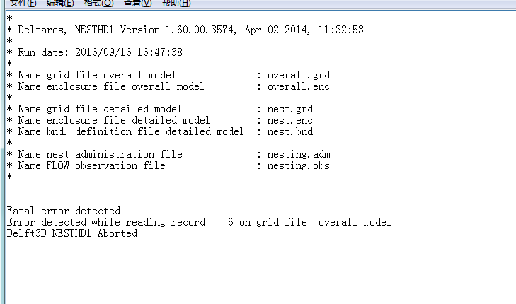

Hi there,
When I run nest1, there is some problems with it. And I don't konw why?
There says " Fatal error detected. Error detected while reading record 6 on grid file overall model Delft3D NESTHD1 Aborted " in the adm file. What's wrong with it? Can you help me?

I know this is old, but perhaps others are struggling with the error. Line 6 must be deleted out of your grid file. It is a line about missing values. "Missing Value = 0.00000000000000000E+00"
