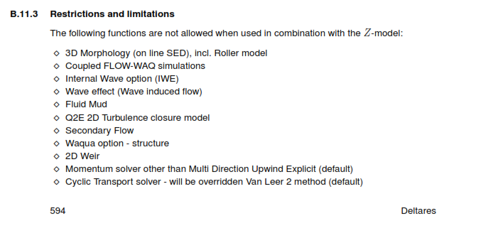

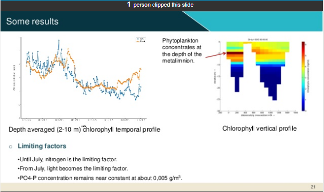

I've read a presentation from Delft Software Days (DSD-INT 2018), it was mentioned on a slide that Z-model is used on the model that is coupled with WAQ. As far as I know, there's a limitation on using Z-grid on DELWAQ module-as I read on the manual-. Is the limitation still on? Cause I need to use it on a Delwaq-model and don't know if it's possible. But it's used in the model related to this presentation.
link to presentation : https://www.slideshare.net/Delft_Software_Days/dsdint-2018-hydrodynamic-and-water-quality-modelization-of-cuerda-del-pozo-reservoir-castrillo
a clip of a slide of usage of z-grid is attached and a clip of the manual page mentioning the restriction on Z-model on WAQ module is also attached.
