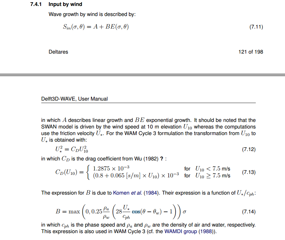

Hi,I am a doctoral student of NHRI, I'm working on a project related to Taihu Lake waves. I need to modify the source code of WINDGROWTH in SWAN, but I couldn't find the code for a long time. Does anyone know where I should find the code? Thank you very much.
