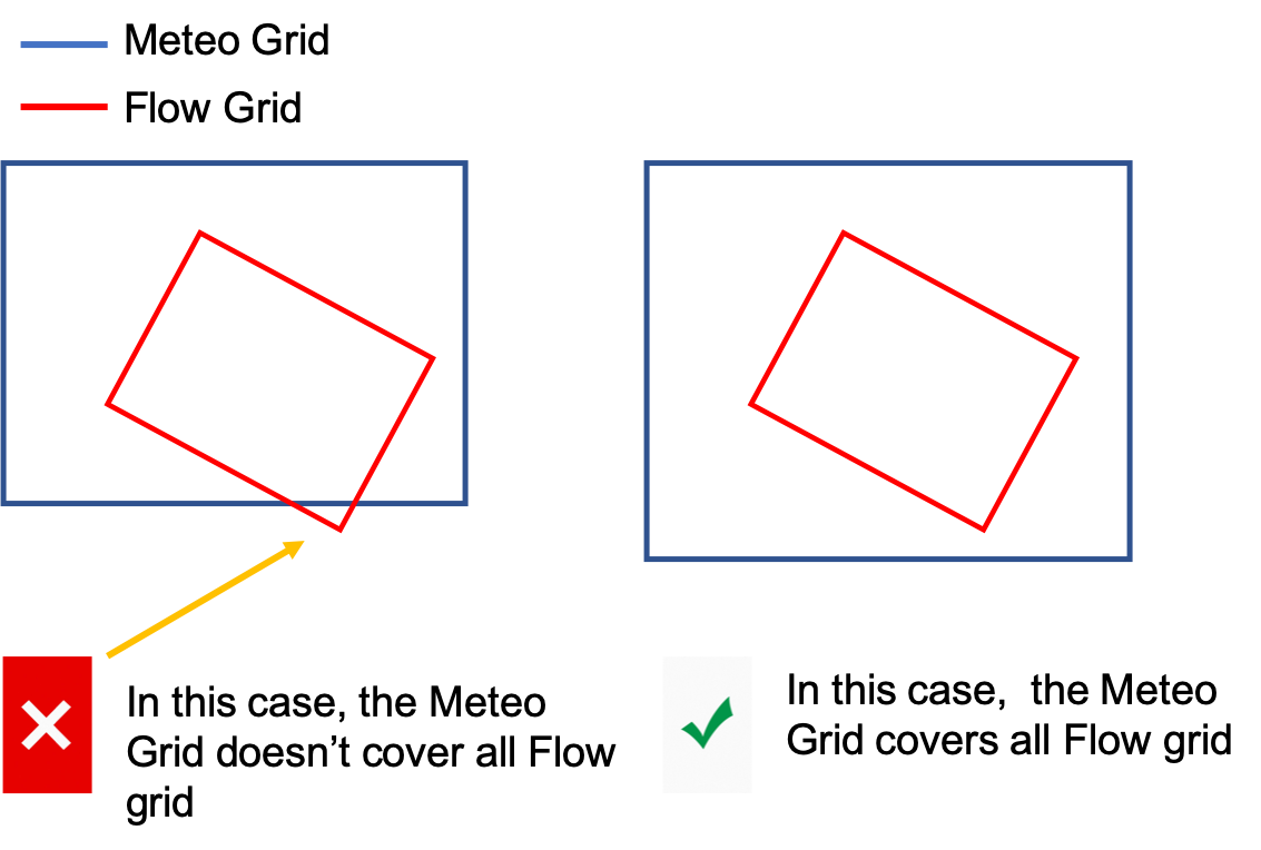

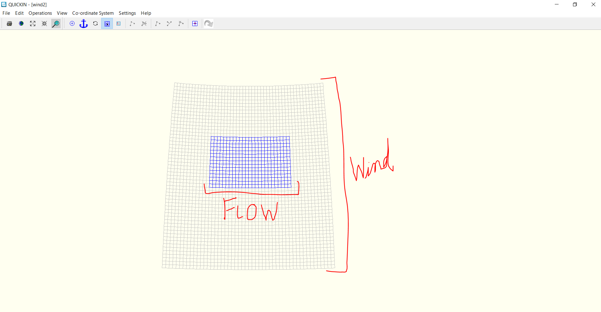

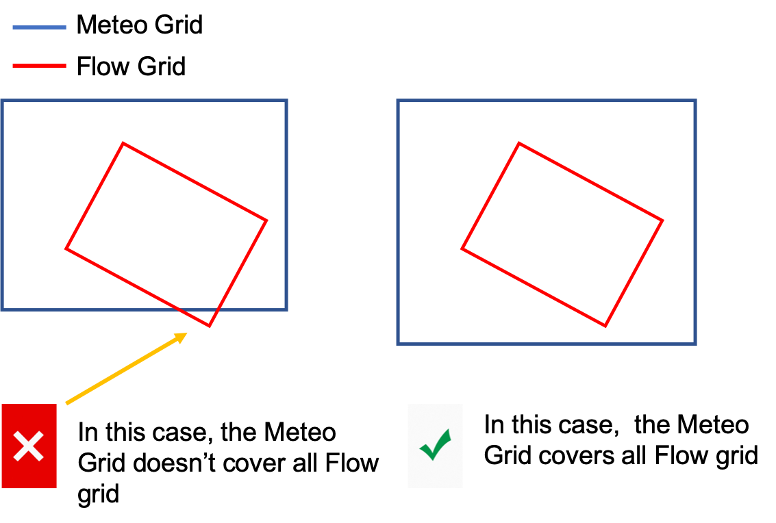

In my case, part of the flow grid wasn't covered by the meteo grid. It was simple to solve.
