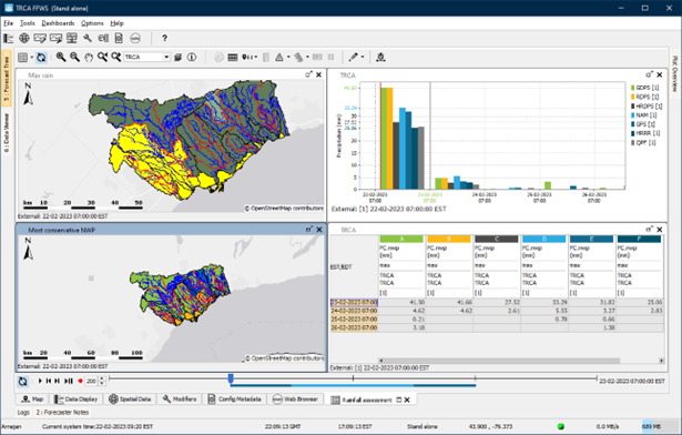

Dashboard showing rainfall volumes from different NWP in one place.

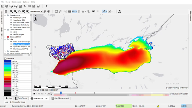

Wave height forecast for Lake Ontario.

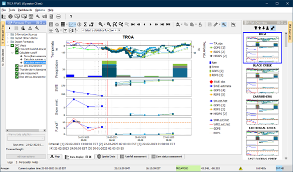

In the second phase of the project, workflows for further assessment of the forecasts were developed. These focus on several aspects of TRCA’s flood forecasting procedures: (1) rainfall volume, (2) summer runoff volumes, (3) winter runoff volumes, (4) ice jam potential, (5) thunderstorms, (6) lake conditions, and (7) dam status. For each of these assessments, FFWS performs additional calculations that replicate those in the DPC. This workflow runs once per day, generating all the information needed for the forecaster on duty to draft the daily communication for flood potential.

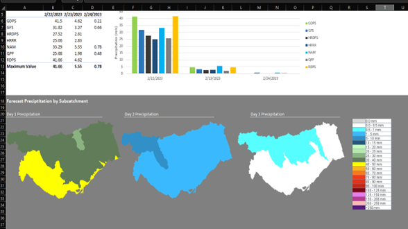

The imported and processed data are disseminated through the Delft-FEWS web services and retrieved by the DPC Excel report formatter. With this new connection, the DPC report contains all the information for a first assessment of potential for flooding in the upcoming days. Further analysis can be done using the FFWS Operator Client, which shows all imported and processed data in informative and clear displays.
Calculations are done for all watersheds in the TRCA jurisdiction.
FFWS data are disseminated via the Delft-FEWS web service, which is accessed by the DPC Excel workbook.
