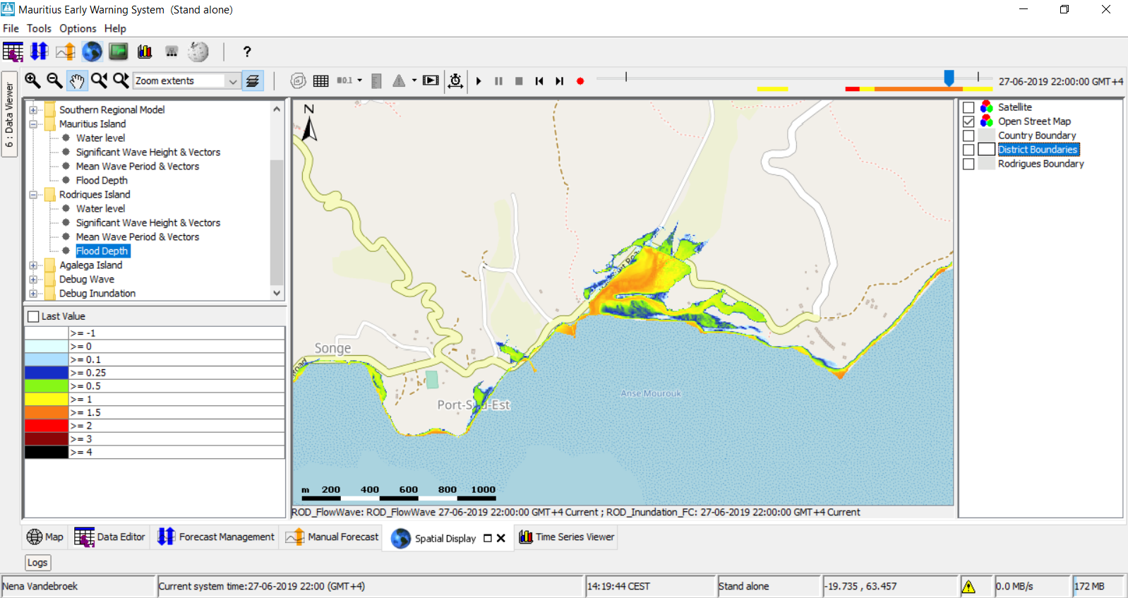

Three detailed flow-wave models, one for each of the main islands, are nested in the two regional models. Meteorological and water level observations are imported every six hours. A GIS-based flood mapping algorithm converts coastal water levels to inundation depth maps.

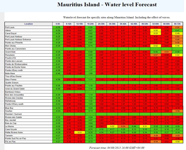

The EWS produces 6-hourly HTML bulletins with water level forecasts and warning levels (Safe, Watch, Alert, or Warning) with a 3-day lead time. The bulletin was designed to be easy to interpret and disseminate, in collaboration with MMS and the National Disaster Risk Reduction and Management Center (NDRRMC).

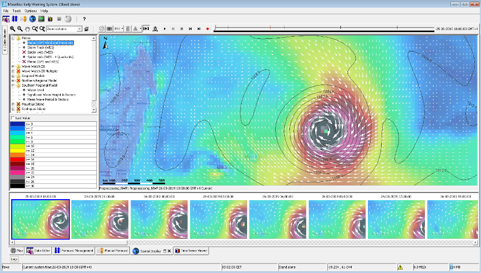

Using cyclone track forecasts to force hydrodynamic models
Another important characteristic of the EWS is the option to use cyclone track forecasts as forcing to the hydrodynamic and wave models. When available, cyclone bulletins from the Joint Typhoon Warning Center (JTWC) are imported into the EWS. These bulletins provide forecast information on position, radius of maximum wind, and pressure drop of the cyclone. The Wind Enhancement Scheme (WES) then uses these parameters to generate spatial wind and pressure fields. Forecasters have the option to modify track parameters based on expert judgement before running the WES module. Wind and pressure fields generated by WES are merged with NOAA GFS Numerical Weather Prediction (NWP) before running hydrodynamic and wave models.

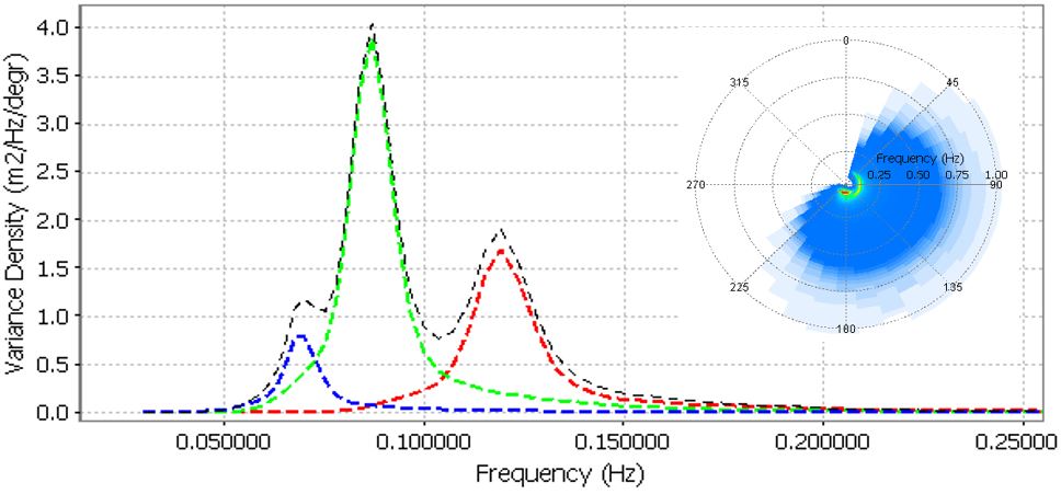

Until now, most operational coastal forecasting systems have relied on simple wave parameter timeseries (e.g. Hs, Tp, Dir) as boundary conditions for regional wave models. In many cases, this works well, when either swell or wind waves dominate a system. However, when both wind and swell waves are present, as can sometimes be the case in Mauritius, the wave energy spectrum cannot be derived accurately from a single wave height, wave period, and direction.
The Mauritius EWS is the first Delft-FEWS which uses spectral wave boundary conditions derived from freely available and global WAVEWATCH III Production Multigrid forecasts. This data feed provides three wave time series. The first represents wind waves and the other two represent two swell components (“swell1” and “swell2”). These time series can each be converted to individual wave spectra and added together to produce a more complete wave spectrum (see Figure 3). The combined wave spectrum (forecast) can then be provided as a boundary condition to regional wave models.
A new Delft-FEWS transformation module was developed as part of the Mauritius EWS project to generate 1D and 2D wave spectra from a simple wave timeseries, using a JONSWAP spectrum. This functionality is available in Delft-FEWS versions 2017.02, 2019.01, and newer. Simple User transformations can then be used to add the separate 1D or 2D wave spectra together.
