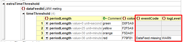

Add an (optional) eventCode and a logLevel to the time threshold in your SystemMonitorDisplay.xml. Note that you should only do it for the situation that there really is an issue, so in this example after 36 minutes, when it is displayed as red:

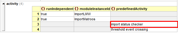

Add the predefined activity “import status checker” to your workflow:
In case a time threshold is now exceeded, a WARN message will be logged, with eventCode “DataFeed.missing”.
