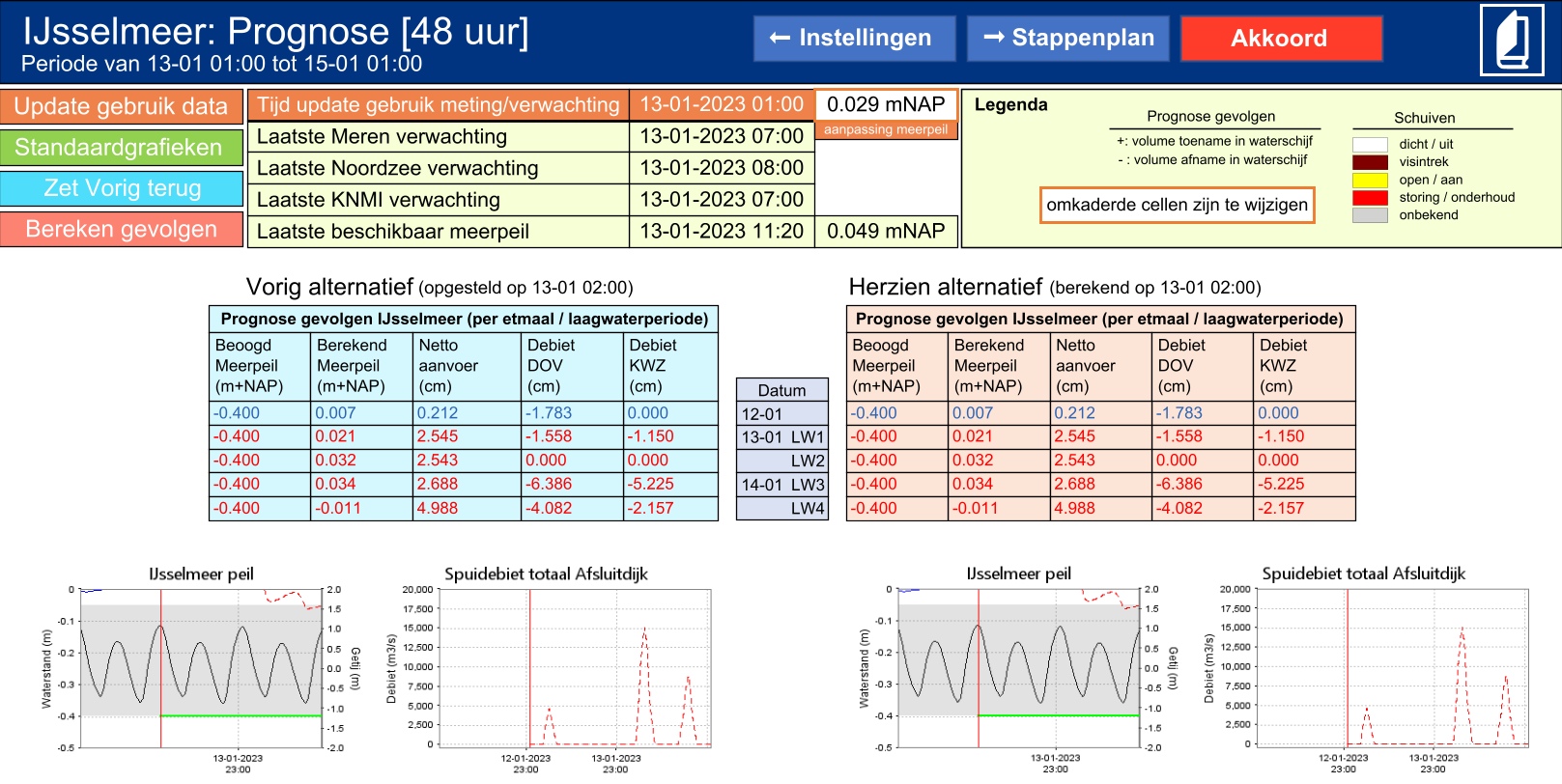

Did you know that since 2021.02 it is possible to add thumbnail graphs in the SSD (Schematic Status Display)?This is done by using the chartComponentBehaviourDefinition element in the schematic status display. The element includes a function to refer to a pre-configured plot in the DisplayGroups configuration file, so that time series charts from there can be inserted into the SDD. In the picture below (in Dutch) the four graphs at the bottom are nice examples for such thumbnail graphs. More information can be found on this WIKI page.
