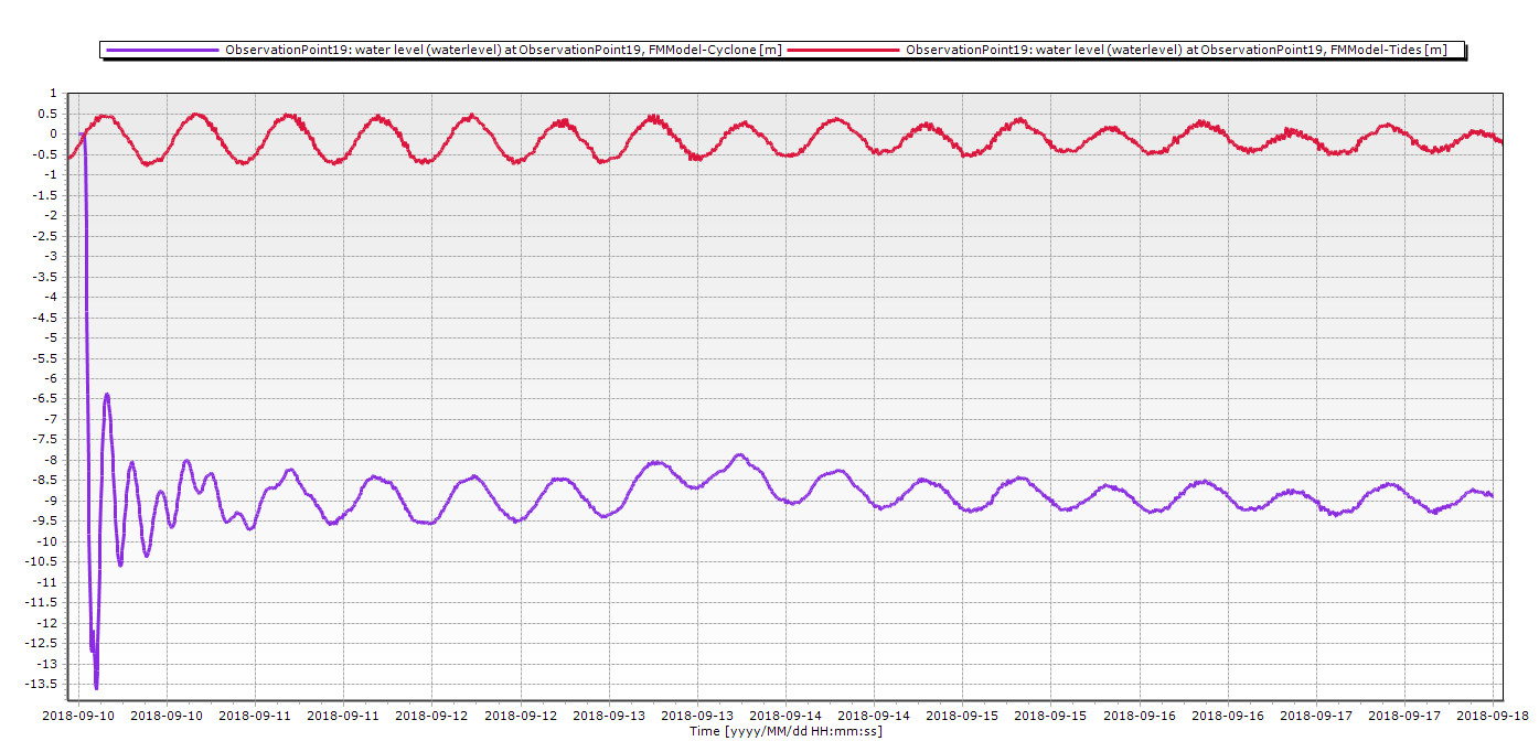

I am trying to set up a coastal flooding model using Delft3D FM for Hurricane Florence, NC, USA. However, the model without wind and pressure fields shows tidal water level liitle bit reasonable but with wind- and pressure-field of Florence, it shows wiered results. Could anyone give me some expert comments on that how I can improve the model.
here is my Water Level with, and without hurricane, the lower one is for the hurricane, where water level has drastically depressed instead of increasing!
I have also added the pressure field of Hurricane from HWRF.
